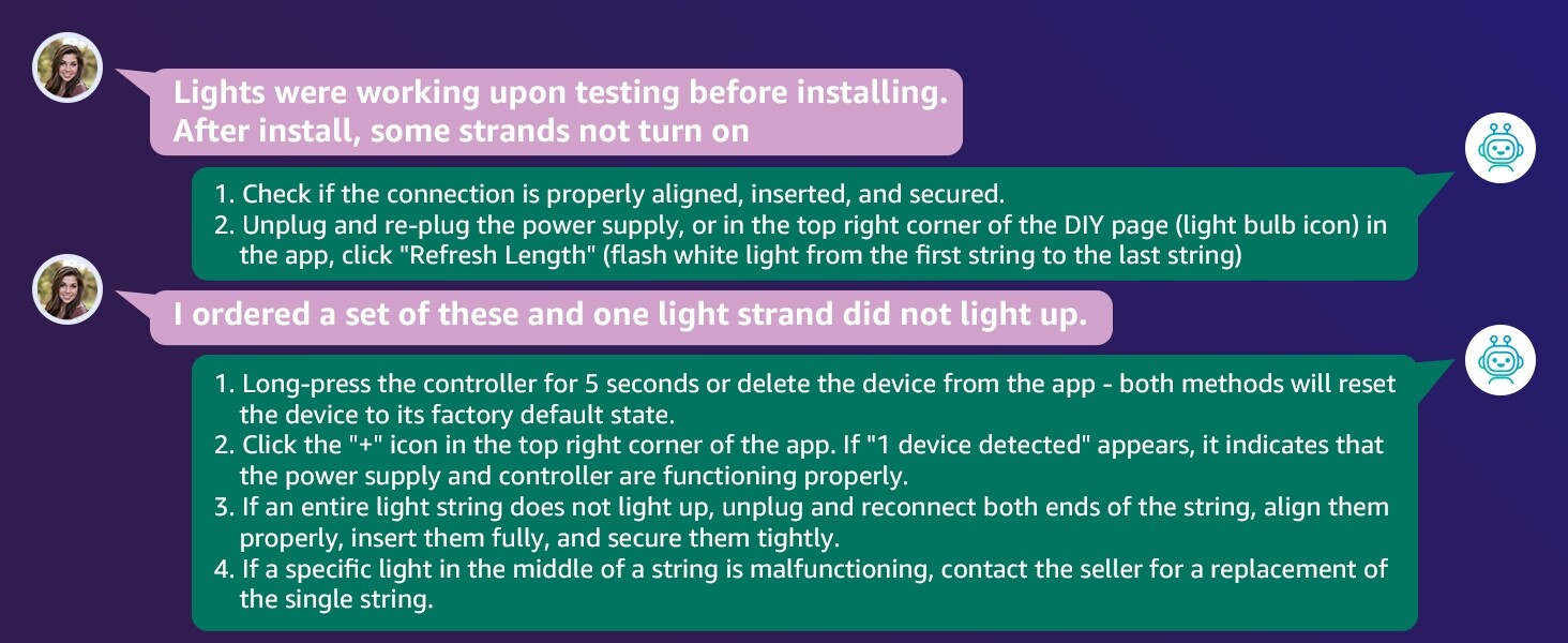

  • Please unplug and reconnect the strands that aren’t working to ensure a secure connection.
  • Then go to the DIY page on the app and click 'refresh the length'.
  • If the problem persists, please let us know specifically which string of lights stopped working—did the first light or a light in the middle of the string stop working?
  • Please also refer to the troubleshootings guide below.
