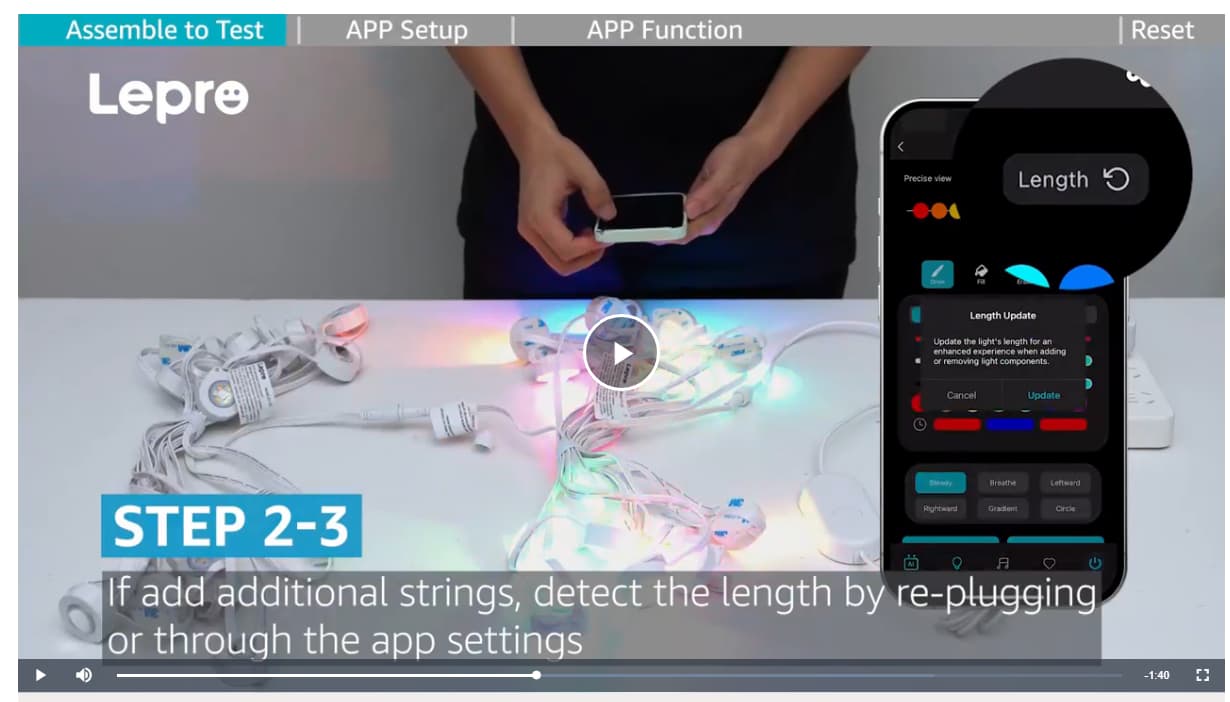

Please select the device, access the DIY interface(the bulb icon) and then refresh "Length" in the upper right corner.
Here is a video of how to set up and app functions for your reference: https://www.amazon.com/vdp/09fef38d8fb6463dbe9b5708880eabbd?ref=dp_vse_ibvc1

Please select the device, access the DIY interface and then refresh 'Length' in the upper right corner.
