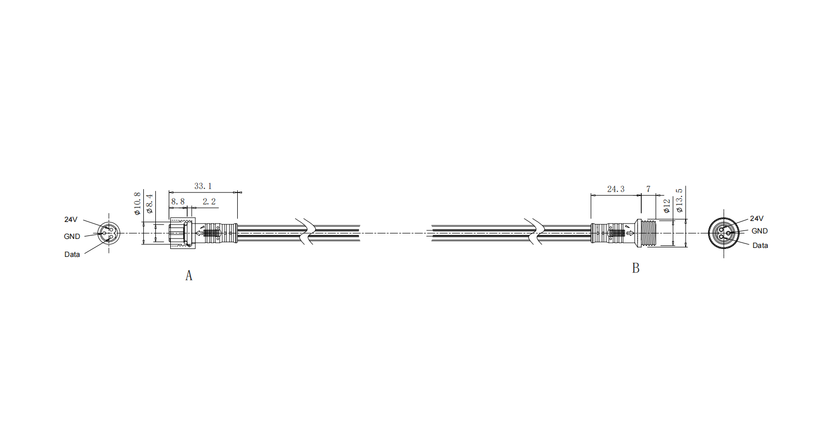

Also what type of connector is the 3 pin waterproof connector for the controller?

The controller uses a 3-pin waterproof connector, which is identified as the B connector in the diagram:
